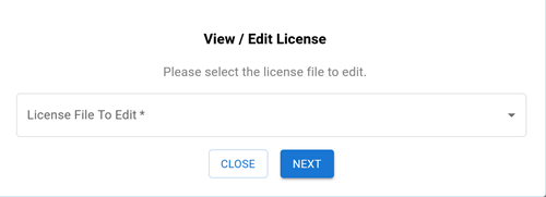

Select View/Edit License(s) from the server administration Home screen Server menu.
The View/Edit License screen opens.
Select the license file you want to edit from the License File to Edit list.
Click Next.
