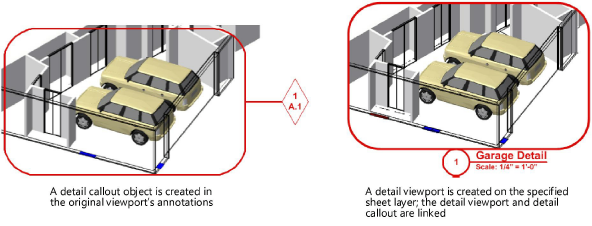

The Create Detail Viewport command creates a cropped sheet layer viewport that shows a detail view of any part of a drawing. A detail viewport can be created from a design layer, another sheet layer viewport, or a section viewport.
The viewport and its associated detail callout are linked, for easy navigation between layers. If the detail callout is moved or reshaped, the detail viewport updates accordingly. The detail callout marker can also be set to automatically update if the detail viewport is renumbered or moved to another layer.

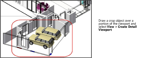

Create either a detail callout or a simple crop object (such as a circle or rectangle) on a design layer, on a sheet layer viewport, or inside a viewport annotation group. See Creating detail callouts.
Select the detail callout or crop object and then select the command.
Alternatively, right-click the detail callout and select the command from the context menu, or click Create Detail Viewport from the Object Info palette.

The specified sheet layer is activated, and the detail viewport is placed in the center of the sheet. If used, the original crop object is converted into a detail callout object.
