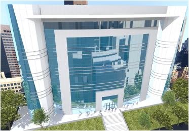

The Vectorworks program models the curtain wall frames, panels, and connections according to real-world architectural standards. Energy-related information specified for curtain walls is considered when conducting an energy analysis (Vectorworks Architect required). Doors and windows have special capabilities when they are inserted within curtain walls so that all the design elements work together.
Curtain walls consist of a repeating grid of frames and panels. From the Wall Preferences dialog box, specify the number of horizontal and vertical frames that make up one section of the curtain wall, and then specify the appearance of the frames and the panels within that grid. The defined section is repeated over the length and height of the wall.
