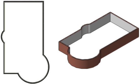

The Wall tool creates hybrid wall objects, simultaneously adding both a 2D and a 3D version of the wall to the drawing; individual walls can be joined into a wall network. Walls can be drawn in Top/Plan or in a 3D view. Straight walls and curved walls, and standard walls and curtain walls, are all created using the same tool. See Wall direction for details on how the starting point and direction in which the wall is drawn determines the wall’s interior and exterior sides.

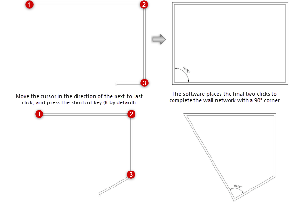

When drawing a wall network, move the cursor in the direction of the next-to-last click but press the shortcut key (K by default) instead of clicking; the software extrapolates the correct alignment and position for a 90° corner and places the final two clicks to complete the wall network.
