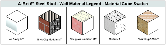

The Graphic Legend tool creates annotated graphic legends and schedules on sheet layers (not available on design layers). For example:
Electrical and plumbing symbol legends
Keys to fill or pen attributes

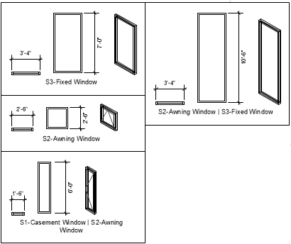

Detail schedules for windows, doors, or partitions
In each cell, the legend can show one or more views of the object, or it can show a specific attribute applied to the object, such as the line type or material.
