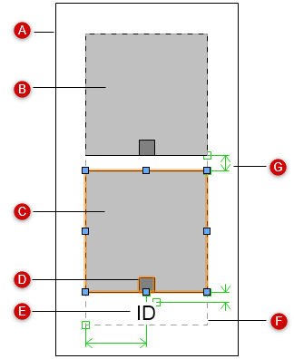

Graphic legend: Editing the cell layout
Edit the cell layout to fine-tune the image display and optionally add text fields and 2D geometry. You can create multiple images in the layout. When you add or rearrange objects in the layout, the cell frame adjusts automatically. The layout must include the frame and at least one image.
Cell layout with two images and a dynamic text field
A: Cell frame B: Placeholder for second image C: Image placeholder (selected) D: Alignment indicator E: Dynamic text field F: Bounding box of cell contents G: Constraint |
Select the legend, and from the Object Info palette, click Edit Cell Layout. For a styled legend, see Editing plug-in object styles. The cell layout displays in editing mode.
Alternatively, right-click the legend and select Edit Cell Layout.
Select the image placeholder to access image editing options in the Object Info palette, including the image width and height, vertical and horizontal alignment, and the option to include auto-dimensions when aligning objects. Click Define Legend Image to adjust the image definition (see Graphic legend: Defining the legend image). To see how the image will look in the legend, set the Preview Display to Detail.
Use the Text tool to add static and/or dynamic text objects to the layout. From the Object Info palette, specify the appearance of the text; see Formatting text.
Static text simply shows the text object in each cell.
Dynamic text shows data from the object in the image (for example, the window ID) in each cell, in place of the text object. To create dynamic text, select the text object and select Use dynamic text from the Object Info palette. Then click Define Legend Field (or double-click the text object) to open the Define Dynamic Text dialog box and define the field. See Defining dynamic text.
Add 2D geometry such as arcs, circles, and lines to the layout, if desired.
To add an image to the layout, duplicate the default image placeholder, and then place the new image and define it as desired.
To adjust the margin between the cell contents and the cell frame, select the frame and edit the margins in the Object Info palette. The frame cannot be deleted from the layout.
The Graphic Legend Layout Constraints on the Object Info palette control the positions of the image, text, and 2D objects within the cell. The options available depend on the type of object.
Click to show/hide the constraints.Click to show/hide the constraints.
Constraint |
Description |
Use auto constraints |
Maintains a fixed distance between the selected object and other constrained objects. Optionally, select Align in column to align the objects. |
Align in column |
When Use auto constraints is selected, select this option to align objects using the distance indicated in the layout as the minimum distance between the objects.
Objects and text auto constrained without alignment (left) and with alignment (right) |
Constrain object distance from boundary |
If Enable boundary constraints is selected for the graphic legend, constrains the distance of the selected object from the left, right, top, and bottom cell boundary. See Graphic legend settings. For 2D graphic objects, deselect the Fix width or Fix height option to scale the object horizontally or vertically to fit the bounding box when necessary. |
When you’re done editing the layout, click Exit Graphic Legend Cell Layout.
