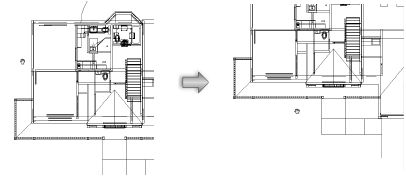

Use the Pan tool to move the drawing around the drawing window, changing the area of display. When in an uncropped perspective projection, the Pan tool moves the viewpoint in the model while the line of sight remains centered in the window; see Projection.
To pan around the drawing:
Click the tool.
Move the hand into the drawing window.
Click and hold down the mouse button, and drag the drawing around the screen.
The rulers move with the page.
When the drawing shows the desired area, release the mouse button.
Areas of the drawing that were off the page do not display until the mouse is released.
Double-click the tool to refresh the drawing view.
