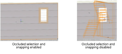

Use occluded selection and snapping |
In rendered views, solid objects "occlude," or hide, objects behind them. Keep this option enabled to more easily select, and snap to, solid objects without interference from hidden geometry. To access hidden geometry, use the X-ray Select mode of the Selection tool, turn on the clip cube, or switch to Wireframe render mode; see X-ray Select mode.

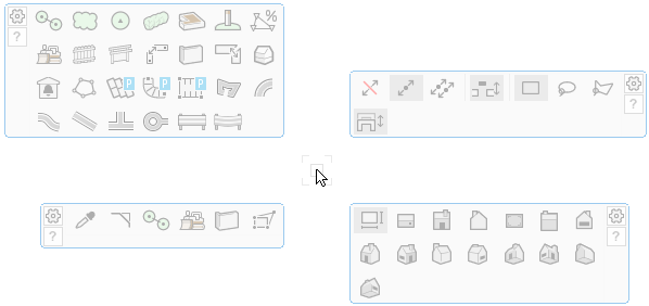

Display Settings |
Customize the Smart Options Display to fit your workflow |
Show Initial Options as |
Select how the contextual hints display when triggered in the drawing area. Icons only displays the contextual hint icons.
Text only displays the contextual hints by name.
Icons and text displays contextual hints by both icon and name.
Fully expanded displays the full palette instead of contextual hints.

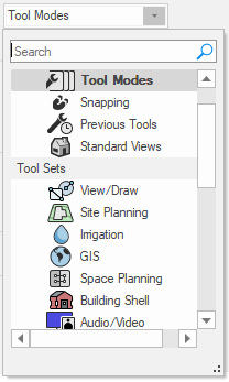

Quadrant selections |
For each of the four quadrants around the cursor location, select which options to display. Enter text in the search box to filter the list.
Under General Options, Tool Modes displays the Tool bar options, such as modes, style lists, and the Preferences button, for the currently selected tool. Previous Tools displays the four most recently selected tools, in chronological order from left to right. The Selection tool and the Pan tool, which are used so often they would displace other tools, do not display. The Tool Sets list contains only tool sets that are available in the current workspace when this preference is set. Likewise, in the drawing area, the Smart Options Display shows only tool sets that are available in the current workspace. If you set Vectorworks preferences while in the Spotlight workspace, and select the Lighting tool set to display in one of the quadrants, that quadrant will be blank (marked as Off) when Smart Options Display is triggered in a workspace that does not contain that tool set. |
