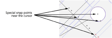

Special snap points
Special snap points display in the general cursor area, to inform you that midpoint, center, along line, and/or tangent snap points are nearby. The visible snap points depend on the enabled snapping tools and settings.

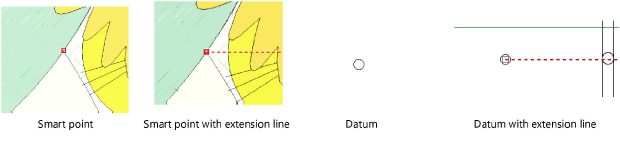

Smart point
When the Smart Points snapping is enabled, up to three smart points can be defined at one time; see Snapping to a smart point. A smart point displays as a red rectangle by default. If extension lines are enabled, the extension line for the smart point appears as a dashed line. A datum is a special type of smart point and counts as one of the three smart points.

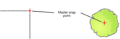

Master snap points
In congested areas of the drawing, when there are many object snap points within the snap box, enable the master snap point display in the Object Snap Settings popover; see Snapping to an object. The master snap point takes priority over other snap points, for quickly obtaining the desired snap point during operations like dimensioning or moving objects.

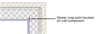

The master snap point location is a property of an object and is primarily intended for use in Top/Plan view. Shapes like rectangles, arcs, circles, and polylines have master snap points at places where they are logically expected, such as corners, centers, or end points. The insertion point is the master snap point location for many of the Vectorworks default content resources and parametric objects; path-based parametric objects inherit the master snap point location from the path object. Master snap points are located on roof and bearing line corners. For curtain walls, the master snap points are located on the center of the frames. Windows and doors have snap points on each end and in the center.
Certain objects allow the master snap point location to be specifically defined. Walls and slabs with components can have master snap points located on the component sides; see Creating wall components and Creating slab components. A locus is used to define the master snap point location for symbols and groups; see Editing symbol definitions.

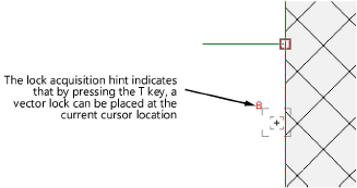

Acquisition hints
Acquisition hints display the potential snap points that can be acquired near the cursor. They indicate that a smart point, smart edge, or vector lock can be acquired.

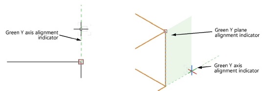

Alignment Indicators
Lightly colored axis and plane indicators provide subtle hints to help determine whether the cursor is aligned to an axis (2D) or an axis and/or plane (3D). The color of the indicator matches the axis color (red for X, green for Y, and blue for Z) to help you determine when the cursor is aligned to an axis or plane.
