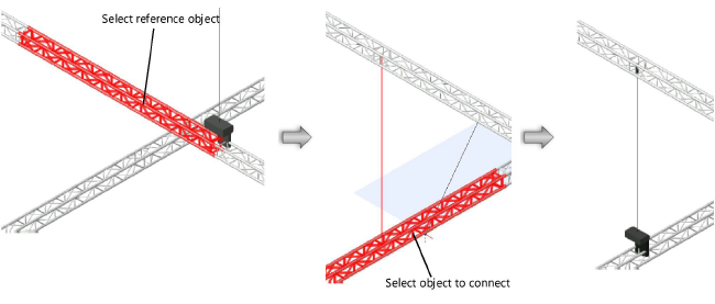

Connecting rigging objects with drops
To connect structural elements with one or more drops:
Click the tool, and then click Insert Drop mode.
If an offset is needed, enter the Offset value and toggle Enable Vertical Offset on.
To automatically number truss crosses as they are placed, click Automatic Numbering, and then click Automatic Numbering Preferences; see Numbering objects at placement.
Click Preferences to open the Connection Options dialog box. Select whether to insert the drop as a dead hang bridle or a hoist; if inserted as a hoist, from the Resource Selector, select the hoist symbol for the drop. If desired, select the option to use a truss cross symbol for the connection, and select the symbol from the Resource Selector.
Click on the reference rigging object; this truss does not move.
Click on the rigging object to move either up or down (stacking the moved truss below or above).
Valid rigging objects are highlighted, and a preview of the drop location displays.
Click to place the drop at that location and connect the rigging objects.
If the trusses to be connected require adjustment to be stacked in a parallel alignment, the Move Parallel Systems for Drop dialog box opens. Select whether to move the top truss system (the one with the higher Z value) or the bottom truss system into correct alignment. The selected item is moved.
In some cases, when changing the high hook height of a hoist inserted with the Hoist tool, you can choose to ignore the potential association with the truss.
The selected hoist is inserted.

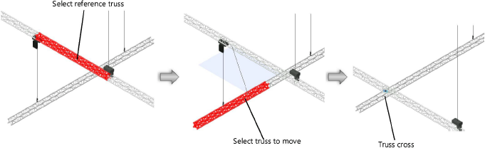

Connecting rigging objects with a truss cross
To connect rigging objects to each other with a truss cross:
Click the tool, and then, depending on whether you want to stack a truss above or below another one, click either Place Rigging Object on Top or Place Rigging Object Below mode.
To automatically number drops as they are placed, click Automatic Numbering, and then click Automatic Numbering Preferences; see Numbering objects at placement.
Click Preferences to open the Connection Options dialog box; select whether to use a symbol for the truss cross, and if so, from the Resource Selector, select a truss cross symbol. If you don't select a symbol, a rigid truss cross is inserted.
Click on the reference truss; this truss does not move.
Click on the truss to move (stacking the moved truss above or below the reference truss).
The truss is stacked with the reference truss, and any connected hoists, attached loads, and supports move with the truss. If hoists are connected between the trusses, they are removed; hoists connected to other truss sections may be lengthened or shortened.
A truss cross is created at the connection point. A truss cross indicates how to calculate and model the connection between stacked trusses. Depending on the selected symbol, its appearance indicates the type of connection (whether it is connected, flexible, or rigid; can transmit all forces, or only tension or only compression forces, or no forces). A label indicates the truss cross's name, type of connection, and the current force.
