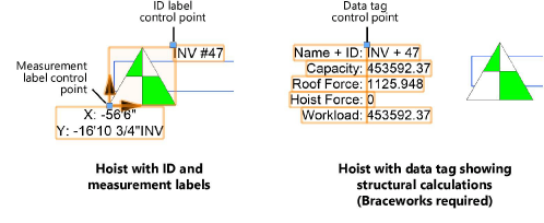

Optionally, hoists can display an ID label and a measurement label. Use the Data Tag tool to add a detailed label after placing the hoist; see Adding data tags and labels.
