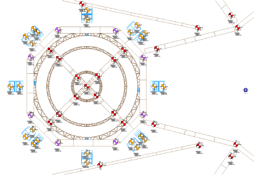

Hoists are used to suspend the rigging from the venue’s supports. Create the venue design, including the house rigging points or structural members. Place the required rigging and equipment such as trusses, loads, and stage pieces. See Creating a venue file.
Optional: Use the Convert Old Hoists command to convert any hoist objects created prior to Vectorworks 2021, for improved performance.
Click the Hoist tool, and select a hoist symbol to insert. Apply automatic numbering so the hoists can be identified in labels and reports.
Select the appropriate insertion mode (Standard Insertion mode, Single Click Insertion mode, or Distributed Insertion mode). If selecting Distributed Insertion mode, click Hoists to Insert on the Tool bar and set the number of hoists to insert.
Click to attach the hoist to a rigging object, structural member, or house rigging point. When inserted on a house rigging point, a hoist can automatically connect with a truss below that point.
To change the type of hoist, click Select Symbol on the Object Info palette, and select a different hoist symbol.
Click Select Pick-up Symbol on the Object Info palette to specify how the hoist connects to the truss. Once selected, the Pick-Up Weight is applied and Pick-Up Capacity checks are performed and displayed in the Object Info palette.
