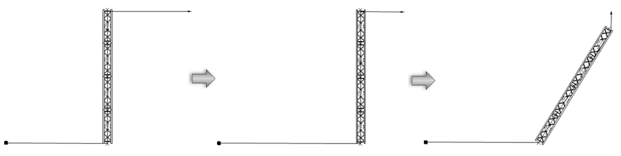

After reshaping, the cable run parts are rebuilt using the correct number of parts based on the inventory and new cable length, and the connections update.
A cable run automatically adapts when the cable path it follows is reshaped, or when the cable path or truss system path is moved or rotated.
