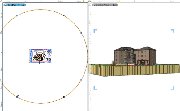

An Orthogonal Orbit type or Fly Freely type animation path is created on the active design layer. Keyframes are automatically placed around the path, and a triangular shape that indicates the camera view displays at the beginning of the path. See Editing animations to reshape the animation path, fine tune the camera’s views, and adjust the speed along the path.
The model with the orbit animation path in the left view pane, and the active camera view in the right view pane
