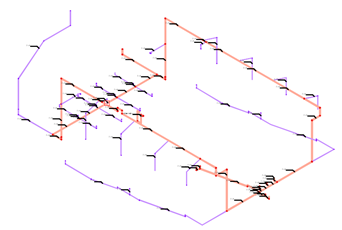

A riser diagram shows the electrician what ducts (cable containers) to install and where to install them. It can be considered a map of the cable ducts, annotated with the duct size and cable information that has been provided by the designer. Riser diagrams are created automatically as viewports on a sheet layer; see Creating sheet layer viewports.

The riser diagram viewport is created and placed on the sheet layer.
