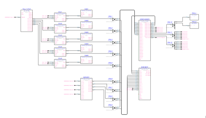

Schematic plan
Using the tools in the Schematics palette, lay out the major components of the system, the required connections between them, and the types of cable required for the connections. Only the logical connections and cabling are diagrammed at this point, without considering the actual physical location.

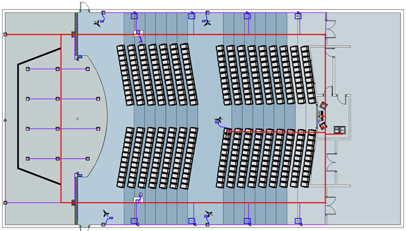

Locate major equipment: Create or obtain, from the architect or project planner, a scaled floor plan or full model of the building or venue.

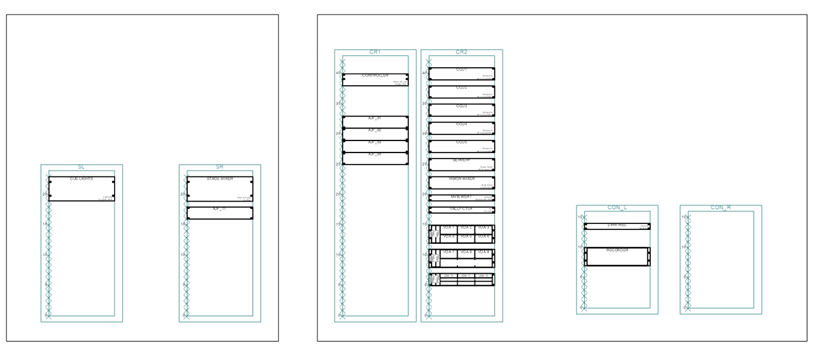

Place the major equipment in the building using the tools in the Event Design tool set and the Equipment Item tool.
Create equipment items automatically with the Create Equipment command; any devices/equipment on the schematic and in layout layers will have corresponding equipment item objects created.
Place or drag an equipment item onto an object from the Event Design tool set to identify it as valid equipment.
Drag the pieces of equipment to the correct location and layers on the floor plan, into 3D equipment racks, and into the model.
Insert drop points: A drop point is the terminus of a cable (where the cable exits). Place drop points in walls, ceilings, and floors as applicable.

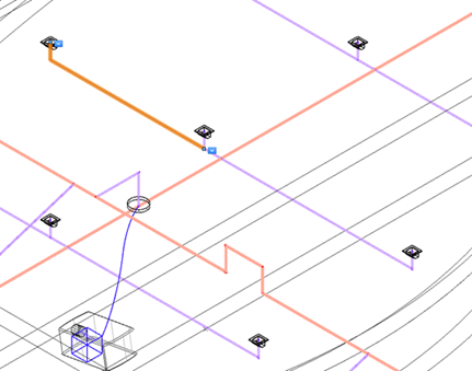

Define 3D cable routing: Use the Cable Route tool to draw networks of cable paths. Cable paths represent the physical routes of ducts and conduits through which cables are routed. The XY mode (horizontal) and the Z mode (vertical) allow creation of cable paths in the proper orientation and elevation. Additional branches (which automatically join and remain connected) can be added to cable paths to create networks of paths.

Connect drop points and equipment items to cable path network: The Cable Route tool associates drop points and equipment items with the network of cable path objects. In XY Insertion mode, define a polyline path at the selected cable height; the tool attaches to drop points, equipment, and other cable paths, making any elevation adjustments needed.
Optionally, you can connect equipment items to drop points; drag the handle of the equipment to the drop point to make the connection. Then connect the drop point to the cable path.

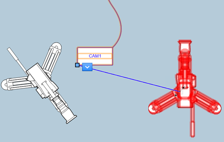

If needed, drag the equipment item handle to a new/different cable path or drop point to re-assign equipment items, or detach equipment items from the cable path or drop point.
Moving an equipment item designation from the camera on the left to the camera on the right

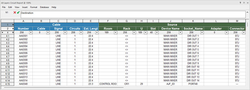

Use the reports described in Creating ConnectCAD reports to get lists of cables/circuits in the cable path, cable lengths, and so on.
Additional helpful worksheets are in [Vectorworks]\Libraries\ConnectCAD\Samples. For example, Sample Worksheet.vwx lists the intermediate drop point IDs through which circuits pass; this helps when planning cable installations.

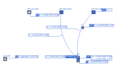

On the cabling sheet, cable runs are indicated as arcs between drop points, or “home runs” to named locations. The runs are annotated with the quantities and types of cables for each run.

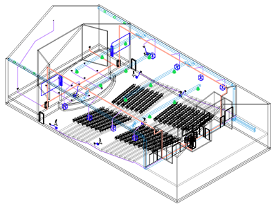

Riser diagrams are maps of the entire cable path system. They show the routes on individual floors and between floors. Routes on a riser diagram are typically annotated by the designer with the suggested size and type of cable containment (conduit, duct, cable tray, etc.).
