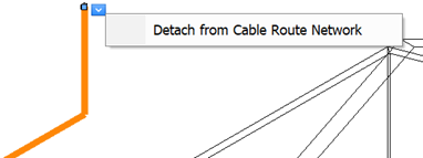

A connected cable path object can be disconnected from the network. Select Detach from Cable Route Network from the drop-down context menu.

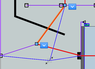

Use the Reshape tool to change the route of the cable path; double-click on the cable path to activate the Reshape tool, or right-click on the object and select Edit Path. Connectivity of the cable network is maintained while moving or reshaping cables.
The available Reshape tool modes are identical to those for the NURBS curve (see Reshaping NURBS curves), plus additional sub-modes for the Vertex Move, Add Vertex, and Move Edges Parallel modes. These constraint sub-modes make it easy to reshape the cable path along existing geometry.
