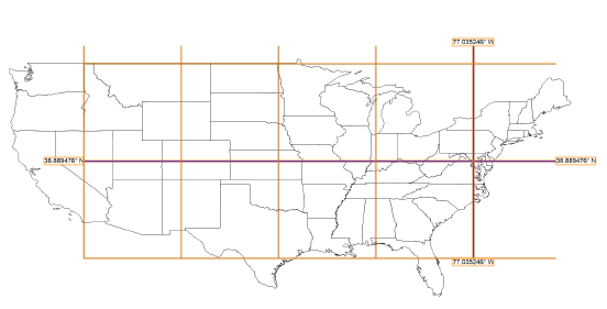

Use the Graticule tool to place a reference grid of real world parallels, meridians, and labels, showing the Earth’s orientation in a given area of the drawing. Unlike a grid that is based on X and Y coordinates, the graticule lines are based on longitude and latitude lines that are inferred from the georeferenced coordinate system.

Click the tool and insertion mode, and then select the polyline creation mode.
Click and drag in the drawing to create the rectangular or polyline boundary in the approximate location of the latitude and longitude lines you specified. Make the area larger than the graticule will be, so the graticule will not be cut by the rectangle or polyline. When you complete the shape, a graticule object is created over the specified location.
