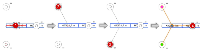

The Click Insertion mode uses multiple clicks to insert a bridle object. For most bridle types, the first click defines the bridle’s connection point on the object it will support, and subsequent clicks define the leg insertion points. Reversed two leg bridles are inserted differently.
To insert a bridle manually:
Click the tool and insertion mode.
Click the desired bridle type mode.
If you are working in Top/Plan view, enter the Trim Height of the bridle on the Tool bar.
If inserting a two leg bridle, which is the most common, do the following.
Click to set the insertion point for the top Leg 1, and click again to set the insertion point for the top of Leg 2. The available insertion points are highlighted as the mouse moves over them.
Click a third time to set the down leg, on a line between the first two points. Valid insertion points are highlighted as the mouse moves over them. The bridle object is inserted in the drawing.
If inserting a reversed two leg bridle, do the following. If inserting any other bridle type, proceed to step 7.
Click on the rigging object to set the insertion point for Leg 1, and click again to set the insertion point for Leg 2. The available insertion points are highlighted as the mouse moves over them.
Click on the rigging point where the bridle will attach. Valid insertion points are highlighted as the mouse moves over them. The bridle object is inserted in the drawing.
Move the mouse to the object that the bridle will support, and click to set the connection point. Valid connection points are highlighted as the mouse moves over them.
Insert the bridle legs. For each leg, click on the rigging point where the leg will attach. The available insertion points are highlighted as the mouse moves over them.

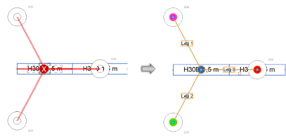

To insert a bridle automatically:
The Auto Insertion mode is not available when inserting reversed two leg bridles.
Move the mouse to the object that the bridle will support.
Using Auto Connect technology, the valid connection points are highlighted, and a preview of the bridle legs is dynamically displayed.
Click on the rigging object to insert the bridle as previewed.
The bridle is inserted in the drawing according to the settings in the Bridle preferences dialog box.
The bridle parameters can be edited later from the Object Info palette; see Bridle preferences.
A different type of hoist can be selected for the down leg by clicking Replace Down Leg with Hoist on the Object Info palette.
