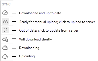

Once connected, data is exchanged between the server and BCF palette as follows:
If only Download from server is selected, the issues from the server project are downloaded, clearing any existing issues in the palette.
If only Upload to server is selected, no issues are downloaded from the server. Issues in the BCF palette are uploaded automatically or manually, as specified.
If both the download and upload options are selected, issues from the server are first downloaded to the palette (updating any existing issues), and then issues are uploaded to the server automatically or manually, as specified.
The Sync column in the issues list indicates the status of each issue, and also allows you to manually upload issues and update issues that are out of sync with the server.
