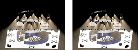

The image on the left uses Very High Sampling with Enable denoising turned off; its render time was 6:01. The image on the right uses Low Sampling with Enable denoising turned on; its render time was 1:31.

Lit fog
Enables creation of volumetric lighting effects, such as a shaft of light in fog, haze, or smoke.
Lit Fog Density (%)
To control the the fog density, drag the slider to the right to increase the density, or enter a density percentage
Animated Lit Fog
Enables the animated fog effects. Animated lit fog is visible only within the lights' spotlight cone. The fog effects preview live as you change the values in this dialog box.
Pocket Density (%) controls the lit fog density in pockets between the maximum density regions; enter a value between 0 (for the pockets to have no fog) and 100 (which creates a completely smooth fog pattern).
Turbulence (%) defines how quickly the fog pattern will change over time; turbulence is independent of the fog direction.
Scale (%) controls how large the clouds and pockets of fog are; larger values result in larger clouds and pockets.
Velocity (%) controls how fast the fog moves on the X, Y, and Z axis directions over time. A value of 0% for an axis results in no movement on that axis; a value of 100% on an axis results in a maximum amount of movement along that axis. Positive values move the fog left to right, and negative values move the fog right to left.
