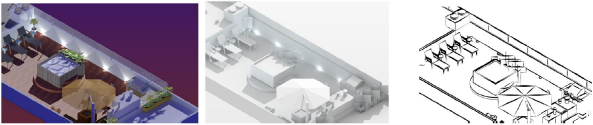

Left to right: Realistic Exterior Night Final, Realistic White Model, and Artistic Taper Thick Black

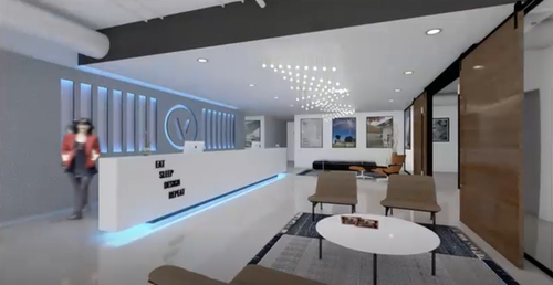

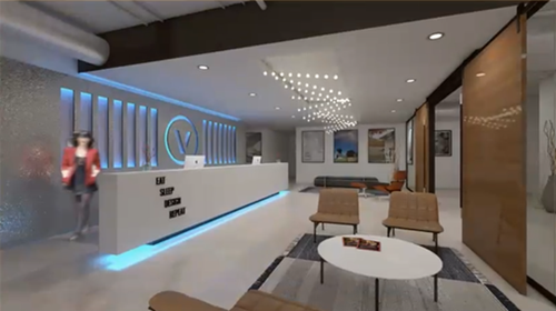

The Realistic render type (top) and Realistic RS render type (bottom) both provide high-quality renderings of this corporate reception area, but they interpret light, reflections, and textures differently
