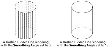

Smoothing Angle
Sets the angle to reduce facet lines when the Hidden Line mode or Dashed Hidden Line mode is selected; if the value is greater than zero, facet lines will be removed between any two faces of an object that are within that angle of each other

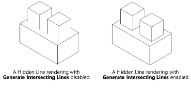

Generate intersecting lines
Generates lines where surfaces in the drawing intersect each other when the Hidden Line mode or Dashed Hidden Line mode is selected; for large files with a lot of curved surfaces, this option can make rendering slower

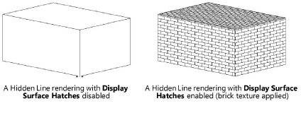

Display surface hatches
Displays surface hatches in a hidden line rendered view
