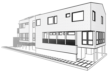

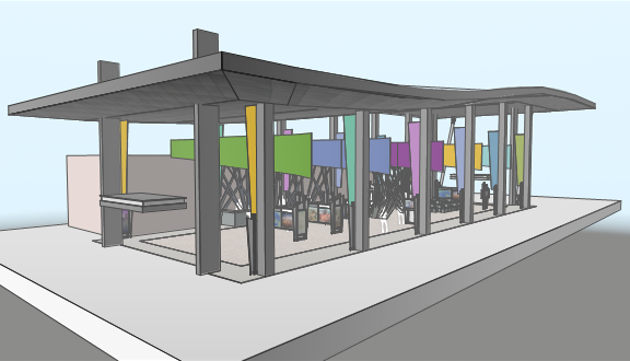

Sheet layer viewports and section viewports, including interior elevation viewports, rendered in Shaded or Hidden Line render modes offer depth cueing options that make perspective and orthogonal views more realistically display objects nearer to or farther from the viewpoint. To add depth to a shaded viewport, apply and define a gradient that desaturates the color of the object fills as the distance increases. To add depth to a hidden line viewport, set the lines' tonal values and/or thickness to recede with distance.
For styled viewports, depth cueing, like other render settings, is available only if the render mode is set by instance.
Because depth cueing is as much art as science, interactive controls on the Shaded Options and Hidden Line Render Settings dialog boxes allow you to use two spot markers to adjust gradients and lines at different points along the entire grade of the rendering. Shaded depth cueing changes are previewed as you make them, for real-time adjustment. Hidden line changes don't preview, but they display as soon as the dialog box closes, with no need to update the viewport.
Depth cueing applies to the entire grade of a viewport, from the closest object in view (or the section plane for a section viewport) to the most distant object in view (or where the farthest extents are for a section viewport). For non-section viewports, it may be useful to display the viewport with a clip cube to limit the extent the of depth cueing.
