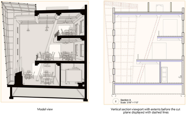

Vertical section viewports create a cross-section view of a model that can be customized in several different ways, as outlined in Creating section viewports.
To create a vertical section viewport:

Display extents before cut plane
Displays geometry before the section cut plane.
