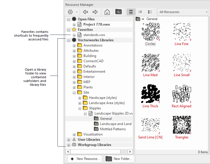

Hundreds of resource libraries are available for use with the Vectorworks application, and you can add custom libraries, as well. In the Resource Manager palette, the file browser pane (on the left) provides easy access to the resource libraries; for even faster access, designate frequently used libraries as "favorites." The Resource Manager lets you view and select the resources contained in library files without opening the files.

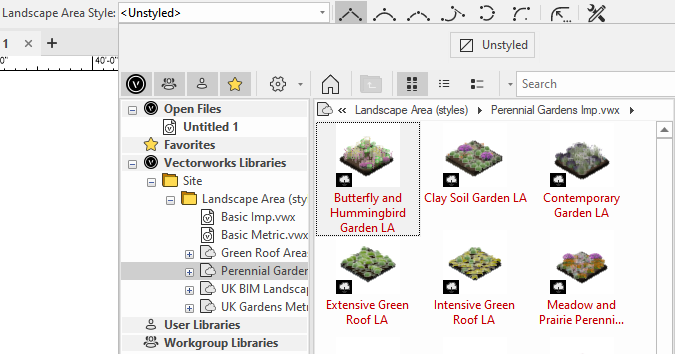

The Resource Selector has a similar browser pane, to provide access to resource libraries at the point of use. For example, you can browse line type resources from the Attributes palette, and browse plant styles (Vectorworks Landmark required) from the Plant tool's Tool bar.
Accessing the Resource Selector from the Tool bar
From both the Resource Manager and Resource Selector, you can drag a library resource to a file in the file browser pane to easily import it. From the Resource Manager, you can also drag a library resource directly onto your drawing.
The Resource Manager and Resource Selector allow you to browse the content online, and they will automatically download the required files on demand. If you work mostly offline and would like to have the content locally available, you can add these libraries during installation, or download them any time with the Vectorworks Package Manager (see Installing Vectorworks libraries locally).
The Vectorworks libraries are available to all users. New libraries are added periodically, as well. If your library catalog is out of date, an alert displays when you launch Vectorworks. Click Update or Download and Update to bring your libraries up to date.
The libraries available depend on which Vectorworks products you have licensed. The files are organized by professional discipline and subject, but not by Vectorworks product, since many resources are available in multiple different licenses. Resources used for similar purposes are grouped together. For example, resources available from the Attributes palette, such as hatches and line types, are in the Attributes folder; resources such as render styles, textures, and image props are grouped in the Visualization folder; and resources needed to design a building, such as wall styles, door styles, foundations, and fixtures, are in the Buildings folder. The Default libraries include content used when configuring a tool's preferences; general resources, such as text styles, that are accessed from multiple locations in the software; parts used to create larger objects, such as door hardware; and so on.
