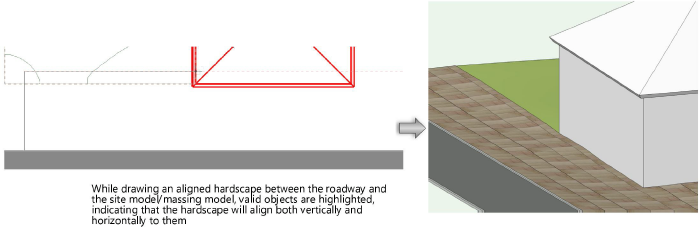

Aligned hardscape
Draw the hardscape with the Site Model Interaction set to Aligned. See Creating hardscapes and Hardscape preferences. Draw the hardscape by tracing along the edges of valid objects that the hardscape should align to; the edged of eligible alignment objects highlight as the cursor moves over them. Alternatively, the hardscape can be drawn first and either transformed (moved or reshaped) or converted into a hardscape aligned with adjacent objects later. The resulting hardscape’s edges are vertically aligned with elevations along the edge where the objects meet.
