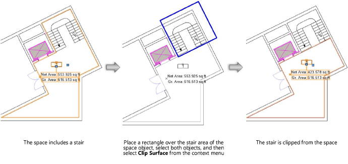

Editing space geometry with 2D modifiers
You can adjust the boundary of a space with 2D modifier objects. Position a closed 2D shape (for example, a rectangle or polyline) on the space object, select both objects, and then right-click and select the Add Surface, Clip Surface, or Intersect Surface command from the context menu. If the space has multiple space polygons, select whether to apply the change to the entire space, or select the space areas to apply it to. An auto-bounded space remains associated with the walls after the operation.
