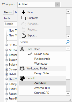

In the Workspace Editor dialog box, click in the Workspace field to see the list of workspaces and action options; the workspace list is divided into sections based on where each workspace is saved. Click the workspace to manage. The active workspace displays with a check mark in the left column, but you can select any workspace to manage. The workspace being edited displays in bold font.
The check mark indicates that the user's customized version of the Design Suite workspace is the active workspace; the bold font indicates that the default Architect workspace is currently being edited. When the changes are saved, the custom copy of the Architect workspace is copied to the user folder; the default Architect workspace is left unchanged.
