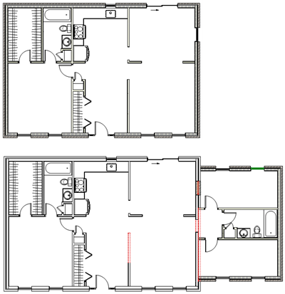

Use data visualizations to control which instances are visible and their appearance in the design layer or in a sheet layer viewport at any given time, based on their status in the active phase. Without data visualizations, all objects in a drawing appear the same, regardless of when they were created, removed, or relocated; data visualizations are necessary to display the time element of phasing in the drawing area.
Data visualization displays the changes between the first phase and the second phase
