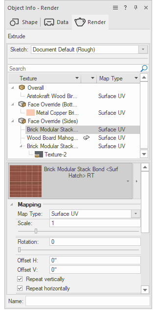

Click the Render tab from the Object Info palette and specify the rendering settings. These changes are visible immediately in the drawing, as the selected object is re-rendered.
Parameter
Description
Sketch
Assign the object's sketch rendering style, if desired; see Sketch rendering
Mode
For objects with texturable components, such as walls, roofs, slabs, and hardscapes, select whether to apply the texture By Object or By Component.
For the best drawing accuracy, use an object style with textures assigned by style, or assign textures to object components, and set this parameter By Component.
Search
Enter text in the search box to filter the Texture browser list
Texture browser
The textures applied to the object display, divided into expandable/collapsable groups. Most objects can have different textures (including decals) applied to different faces, components, or parts. See Textures on 3D objects and Textures on objects with components for information about how different object types display, and when they are editable, in the browser.
Select a list item in the Texture browser to apply a different texture, or to map the texture on that item. When multiple list items are selected, the same texture/mapping changes are applied to all selected items.
A context menu provides additional ways to manage the list items in the Texture browser; see Texture browser context menu commands.
Click the Map Type column for a list item and then click the disclosure arrow to the right of the current map type to change the texture map type for that entity; see Concept: Texture projection and orientation.
If the texture is set by class, a curved arrow displays in the middle column of the browser and in the Resource Selector. A thumbnail of the class texture displays.
When a decal is applied to a texture, the decal resource displays offset under the entity's main texture browser item. A thumbnail of the decal displays when the decal's list item is selected.
