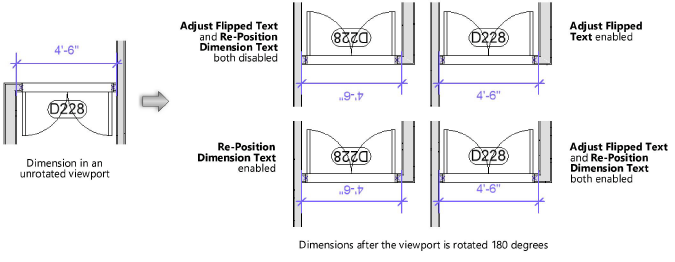

Adjust flipped text |
Re-orients rotated and flipped text in the viewport so that it is always readable. The text box stays in the rotated and flipped position relative to the dimension line, but the text itself is re-oriented. (This setting overrides the flipped text preference for the document; see Document preferences: Display tab.) |
Re-position dimension text |
Re-positions rotated and flipped dimension text in the viewport according to the text position in the dimension standard. The text itself stays in the rotated and flipped orientation, but the text box position relative to the dimension line is changed. (This setting overrides the flipped text preference for the document; see Document preferences: Display tab.) |
