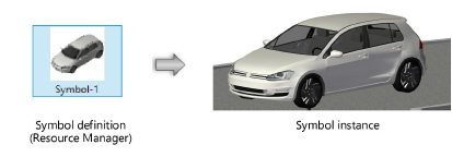

Symbols save objects for reuse. The objects are incorporated into a symbol definition, which is a resource that can be selected from the Resource Manager and Resource Selector. When a symbol definition is placed into the drawing, a symbol instance is created (see Concept: Object instances, definitions, and styles). Vectorworks products provide thousands of symbols as part of the available content. You can also create your own symbols and import the contents of files from other file formats as symbol definitions (see Importing file contents as symbol definitions).
A symbol definition can be created from one object or many objects.
A 2D symbol definition consists entirely of 2D objects. Examples include text, a rectangle, an arrow, or a bitmap. After placement, the symbol instance behaves like any other 2D planar object.
A 3D symbol definition consists of 3D objects, or a combination of 3D and 2D objects. Examples include a sphere, an extrude, or a sweep. After placement, the symbol instance behaves like any other 3D object.
A hybrid symbol definition consists of 3D objects, along with 2D objects specifically for Top/Plan view. After placement, the symbol instance displays the correct 2D or 3D components depending on the view. Examples include plug-in objects like a door, wall, or lighting device, or a custom hybrid symbol you have created.
