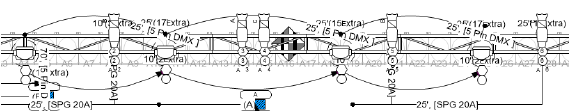

Instead of manually placing data cables or jumper cables on a complex light plot with hundreds or even thousands of lights, the Vectorworks Spotlight software can automatically place the cables in a chain between lighting devices, speakers, projectors, or any symbol.
The Setting Cable Preferences dialog box controls which side to place the cables, and the offset distance between the cables and the lighting devices.

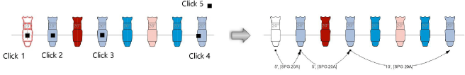

Creating a Jumper Cable Chain
Command
Path
Make Jumper Cable Chain
Spotlight > Cables
To create a jumper cable chain:
  1. Select the command.
  2. The Make Jumper Cable Chain dialog box opens.
  3. Click on each object to be linked.
  4. Click in a blank area of the drawing to finish creating the jumper cable chain.

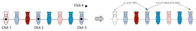

Creating a Data Cable Chain
Command
Path
Make Data Cable Chain
Spotlight > Cables
To create a data cable chain:
  2. As you move the cursor over a valid object, such as a lighting device, the object is highlighted; click on the first object in the chain.
  4. Click in a blank area of the drawing to finish creating the data cable chain.
