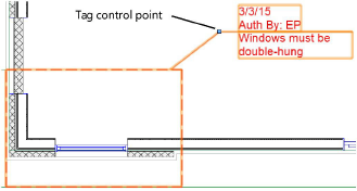

Use the Redline tool to create redline objects, which are graphical time-stamped change requests on the drawing.
Several modes are available.
To redline an object or area:
1.      Click the tool and mode, and then click Preferences to specify the Redline tool parameters for this session.
The Place Redline dialog box opens; set the parameters.
2.      On the design layer where the revision is to be performed, draw the redline around the revision area.
Based on the selected creation method, the appropriate tool creates the redline. This allows the use of SmartCursor cues, object snapping, and boomerang mode when drawing redlines.
3.      The Place Redline dialog box opens. Enter the redline information and authorization.
4.      The redline object indicates the current date and the drawing condition to be corrected. Position redline text by clicking on the tag control point and dragging the tag to the desired location. If there are several redline objects, use the Align/Distribute Leader Lines command to improve readability (see Aligning and distributing leader lines).
