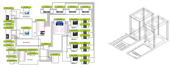

The ConnectCAD suite creates schematic network diagrams of electronic wiring and connections between equipment for any type of connected system, such as IT networks, or broadcast, audio/visual, or lighting systems. The schematic diagram of electronic devices, their connections, and their cables indicates the flow of signals through a system; different types of signals are color-coded. In addition to the schematic view, layout drawings (made to scale) show the physical position of equipment in racks and console bays. All elements are labeled and can be compiled into detailed lists of required cables, components, and parts.

ConnectCAD automates much of the tedious work of creating schematic diagrams and layout drawings.
        Begin by selecting the ConnectCAD template and specifying default preferences.
        Work on the schematic drawing, diagramming how equipment is connected to form a system.
        Place the needed devices. Initially, place basic devices that you customize, or use the Device Builder tool to help create custom devices. Later, when you have a library of custom device symbols, place these symbols with the New Device tool.
        Add sockets to the devices. Signals normally flow from left to right.
        Duplicate similar devices to quickly add them to the drawing.
        Use the Connection tool to link the devices, from the output sockets of a device to the input sockets of the next device, creating a circuit.
