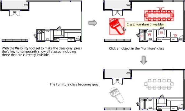

To change class or layer visibilities based on a clicked object:
1. Click the tool.
2.Click Classes or Layers mode, and then select whether to make the object’s class or layer Visible, Invisible, or Greyed.
3.If the class or layer to be changed is currently invisible, ensure that the class or layer options are not set to Active Only. Press and hold the shortcut key (V by default) for the Visibility tool to temporarily make all classes (in Classes mode) or layers (in Layers mode) visible. If the cursor is over a viewport, all classes or layers in the viewport become visible.
In Classes mode, if the cursor is over a design layer viewport that is set to use the class visibilities of the document, all document classes become visible (which includes the classes in the viewport).
4.Move the cursor over a drawing object that is in the class or layer to be changed. All objects that will be affected by the visibility change are highlighted. In addition, a screen tip indicates the name of the class or layer that will be changed, as well as its current visibility setting. If the object is in a viewport, the screen tip also indicates the name of the viewport in which the change will be made.
In Classes mode, if the object is in a design layer viewport that is set to use the class visibilities of the document, the screen tip does not show the viewport name. This indicates that a click on the object will change the class visibility for the document (not the viewport)—including objects of that class that are not in the viewport.
5.Click the object to change the visibility setting for its class or layer.
The object’s class or layer is set to visible, invisible, or gray, and the Message bar shows the change that occurred. The Navigation palette (Vectorworks Design Series required) updates to display the new visibility status. On a design layer, changes to class visibility redraw the entire drawing; changes to layer visibility redraw the layer.
