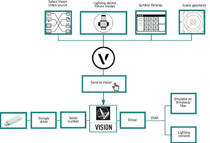

Using Vision with Vectorworks
Vision software is designed to work with Vectorworks Spotlight software. For information on Vectorworks, visit vectorworks.net. For information on using the Vectorworks program, refer to help.vectorworks.net.
