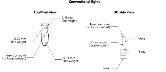

Draw the lighting device’s 2D geometry.
Create a simple line drawing with as few lines and polygons as possible. Try using a single polyline instead of individual line segments. The symbol below was created from these few constituent parts:
Optionally, use the Convert Copy to Lines command to convert the 3D symbol geometry into a simple 2D representation. Delete any extraneous lines. If the lighting device is yoked, remove the yoke geometry.
The size of the lighting device should be accurate based on the real device it represents. Keep the level of detail as minimal as possible. The goal is to distinguish one lighting device from another, not to create a detailed plan view of each device.
For lighting devices with multiple configurations, it is acceptable to use simple graphical differences to distinguish among the models. For example, use the following variations for the different versions of a symbol:
Normally, do not include text labels with the lighting device; these are handled by the object’s label legend; see Setting up label legends. An exception can be made to distinguish different models or lamps of a lighting device. For example, create three versions of a single PAR64 symbol by adding MFL, WFL, and NSP text blocks.
Due to font and scaling issues, the graphical representation described by USITT typically works better than text.

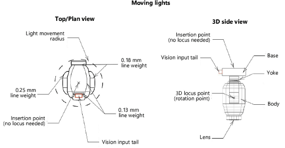

For moving lights, draw a circle around the lighting device to denote the light movement radius. Use a dashed line type. Place the circle’s center point at the device insertion point, and draw the radius to the correct length for the light to sweep.
If exporting to Vision, add an input tail where the lighting device will receive power. Draw a rectangle 100 mm long and 50 mm wide to represent the Vision input tail. This connection point can help you orient the symbol correctly in Vision.
Specify the line weights so the device stands out when printed. The outer perimeter of the symbol should have a line weight of at least 0.25 mm. Interior details should use a lighter line weight, such as 0.13 mm or 0.18 mm.
Use a solid fill for all 2D components.
The end of the device that emits light should point to the top of the drawing in Top/Plan view.

All the parts should be aligned as shown; the yoke rotates about the Z axis, and the body rotates at the height of the 3D locus point.

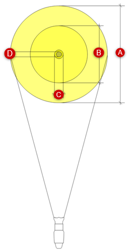

The Candlepower, Min/Max Beam Angle, and Min/Max Field Angle parameters affect the photometric grid and photometer object calculations.
The Min/Max Beam Angle and Min/Max Field Angle parameters control the zoom range of the light beam.
If a light can be zoomed, the Min Beam Angle and Max Beam Angle parameters should be different, with Max having the larger angle. The Min Field Angle and Max Field Angle values should also be different, and larger than their respective Beam Angle parameters. If the Min/Max Field Angle is not specified by the manufacturer, the Min/Max Field Angle values are 1.7 times the value of the respective Min/Max Beam Angle. In this case, enter the following mathematical equation to have the Light Info Record perform the following calculations: 1.7*(Min Beam Angle) for the Min Field Angle  and 1.7*(Max Beam Angle) for the Max Field Angle. These settings produce a round beam that can be zoomed with the slider from the Object Info palette.
Zoomable Lights with Round Beams
A: Max Field (Max Beam * 1.7)
B: Max Beam
C: Min Field (Min Beam * 1.7)
D: Min Beam
If a light cannot be zoomed, set the Min/Max Beam Angle and Min/Max Field Angle to the same values. If the Field Angle values are larger than the Beam Angle values, the round beam has a soft edge. If all four values are the same, the round beam has a hard edge. The angle values are editable from the Object Info palette.
