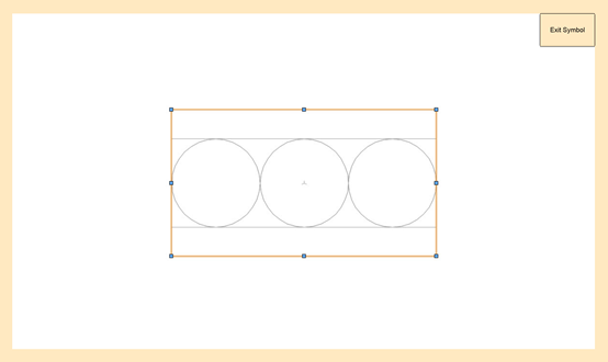

Add a lens to the body. This can be a simple extruded circle of 1 mm at the front of the body. The fill color should be RGB (204, 254, 255).
A cell may have multiple lenses. Use the Align and Distribute tool to duplicate and distribute the lenses within the cell.
Three extruded circles serve as lenses; the cell is pointing downward on the Z axis

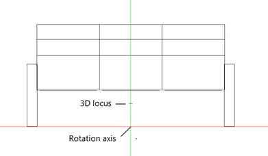

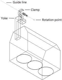

Place a 3D locus within the body at the rotation point for the cell.
The cell rotates about the yoke. If the cell you're creating is not yoked, use a guide line to identify where the rotation point is located on a yoked cell; note the height of this point within the cell. Then, in the unyoked cell, place the 3D locus at the same height and center it between the left and right sides of the cell.
In a yoked cell, locate the rotation point for the yoke
In the unyoked cell, place a 3D locus at this rotation point, centered between the ends of the cell

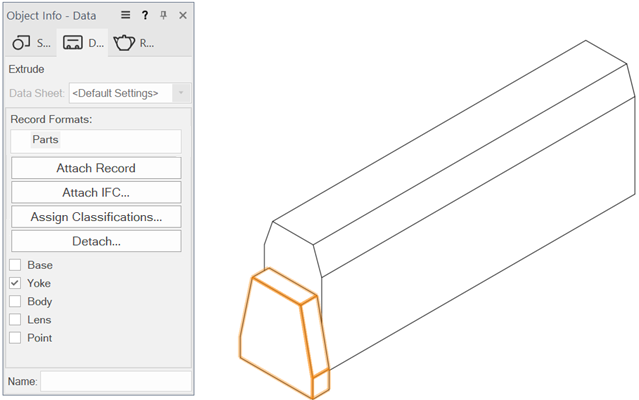

If the cell contains a yoke, base, or accessory, do the following for each of these parts individually. Otherwise, proceed to step 4.
In the Edit Symbol window, select the part.
Click the Data tab on the Object Info palette. Click Attach Record to open the Resource Selector, and double-click the Parts record to attach it.
Select the appropriate part from the record fields: Yoke or Base.
If a part is used for tilting the multi-cell device (moving it along the X axis), that part must be defined as a Yoke. This includes the typical yoke hardware for hanging devices, but also the feet on floor-mounted devices. While the feet provide a base for the device, they must be defined as Yoke parts because the device uses them to tilt.
The foot on a floor-mounted cell symbol is defined as a Yoke part
Clamp accessories are considered Base parts.

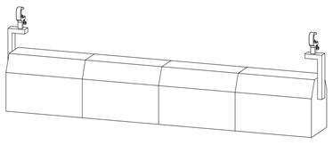

Creating the multi-cell container symbol definition

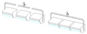

The container symbol is created by aligning the individual cell symbols to form the multi-cell device. Once the cells are correctly aligned, 3D loci are added to define the light emitters and the rotation axis of the device, and the necessary record data is attached.
Multi-cell lighting devices rotate in 3D just like individual lighting devices. The yoke (made from portions of the nested cell symbols) is the means of rotation. A 3D locus point placed in the container symbol defines the axis of rotation.
Floor-mounted multi-cell symbol
To create the container symbol:
Use the Symbol Insertion tool to place the individual cell symbols on the design layer, aligned as needed for the multi-cell device.
Alternatively, locate the cell symbols in the Resource Manager and drag them to the drawing. Do not double-click the cell symbols in the Resource Manager or use the Lighting Device tool to insert them.
The order in which you place the cell symbols determines their index numbers. This is important for selecting and editing the cells in the drawing. The first symbol placed is cell #1, the second is cell #2, and so on. See Concept: Multi-cell lighting devices for more information about index numbers.

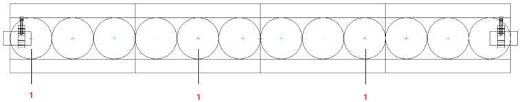

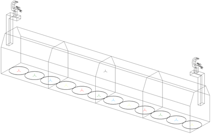

Multi-cell symbols can support multiple light emitters when rendering. Each emitter is associated with a 3D locus point. The 3D locus sets the precise location of the light source. When the Parts record is attached to the 3D locus (light emitter), the record's Light Emitter value determines which cell controls the emitter. All 3D loci with the same Light Emitter value will have the same light properties, as set by the controller cell. This is true even if the emitters are in different cells.
This four-cell strip light contains 12 light emitters. Each emitter has a color-coded 3D locus point. The red locus points are assigned a Light Emitter value of 1. These three emitters will be controlled by cell#1 to shine red light.

In the Edit Symbol window, place a 3D locus point for each emitter in the multi-cell device. Position each locus at the point of light emission. It's recommended that you color-code the locus by selecting a Pen color from the Attributes palette to indicate its light color.
Note that lighting devices with many emitters take longer to render.
