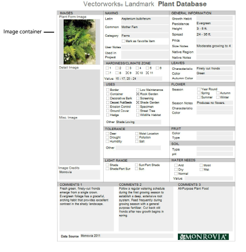

Place an image, video, audio, pasted text, or link to an embedded object into one of three containers; right-click an image container to access the options. The images selected here can be synchronized with images selected on the Plant settings: More Data pane (see Plant settings: More Data pane).
