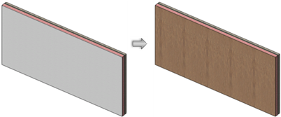

Walls and some other objects with components, such as slabs and roofs, can have textures applied using the Render tab of the Object Info palette.
Click the Wall tool  and Vertex mode .
Click Wall Style on the Tool bar. Under Vectorworks Libraries in the Resource Selector, select a wall style from one of the Fixed Height wall styles libraries. Do not select a generic or curtain wall (CW) style; you want to see some textures in the section thumbnail shown in the Resource Selector.
Click in the upper left quadrant of the drawing to place one end of the wall; move the mouse to the right and click again to finish drawing a wall of the length you want.
The wall already has textures added as part of the style, but you can change them if you want to.
On the View bar, select Right Isometric from the Current View/Standard Views list, or press 3 on your numeric keypad or use the Onscreen View Control cube to switch to that view, to show the texture of the wall interior.

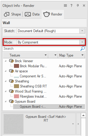

Select the wall, and open the Render tab of the Object Info palette; make sure the Mode is set to By Component.
In the Texture browser, the wall components are listed in order, from the exterior component at the top of the list, to the interior component at the bottom.
Select the interior wall component at the bottom of the list in the Texture browser; the Resource Selector below the Texture browser shows the selected texture.
From the Resource Selector, select a different texture. The wall component's texture changes.
Instead of a bare gypsum board finish, this wall now has wood paneling
