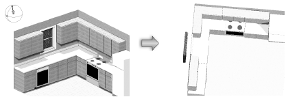

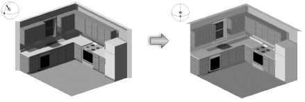

Sets the orientation of the directional, spot, or custom light to that of the current view. This setting can also be accessed from the light context menu: right-click on the light, and select Set Light to View.
Sets the orientation of the current view to that of the directional, spot, or custom light. This setting can also be accessed from the light context menu: right-click on the light, and select Set View to Light.

Select the light; in the Object Info palette, click Set Light to View to set the light orientation to the current view orientation, or click Set View to Light to set the orientation of the view to that of the light |

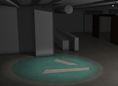

Projecting a texture in a spot light beam
Spot lights can project the color and mask transparency properties of a specified Renderworks texture.
Reflectivity and bump shader texture effects are ignored for the projection.
To project a texture in a spot light beam:
Select a light object with Kind set to Spot, and the light turned On.
Click the Render tab from the Object Info palette and set Projected Texture to Texture.
Click to select a texture from the Resource Selector; a thumbnail view of the selected texture displays.
The spot light beam projects the selected texture onto 3D geometry.
