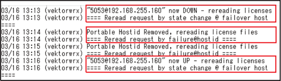

On the backup server, select Diagnostics > View Debug Log from the site protection System Menu.
Alternatively, select View Debug Log from the server administration Home screen Server menu.
The backup server’s Debug log displays. The status of the Debug log will indicate whether the backup server is functioning. For more information about the Debug log, see The Debug log.

The contents of the backup server’s Debug log are explained in this example.
