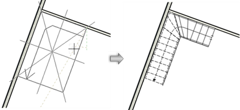

Click to set the start of the rectangle. Move the cursor to start the angle of rotation.
Click to set the rotation angle. Move the cursor until the desired size is previewed.
Click to create the rectangle.
After the rectangle is placed, move the cursor inside the rectangle. As you move the cursor, the potential stair positions preview, based on the rectangle and the selected stair configuration/resource; an arrow indicates the direction of the stair.
Click to place the stair with the desired position.
The Stair tool calculates the stair based on the rectangle and the current stair settings, including the configuration and other geometry settings, such as the Tread Depth and Riser Height. If a valid stair is calculated, the stair is created. If not, either the stair fails, or you are given options to change the invalid settings.
In this example, an L-shaped stair configuration is selected
