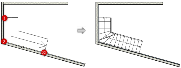

Click to set the polyline's start point.
Click to set the end of the segment and the beginning of the next. The shape and location of the stair previews; an arrow indicates the direction of the stair.
Continue drawing segments; double-click to complete the polyline.
The Stair tool calculates the stair based on the polyline and the current stair settings, including the configuration and other geometry settings, such as the Tread Depth and Riser Height. If a valid stair is calculated, the stair is created. If not, either the stair fails, or you are given options to change the invalid settings.
In this example, the polyline used to create an L-shaped stair must have exactly three vertices; this stair configuration does not require 90° angles
