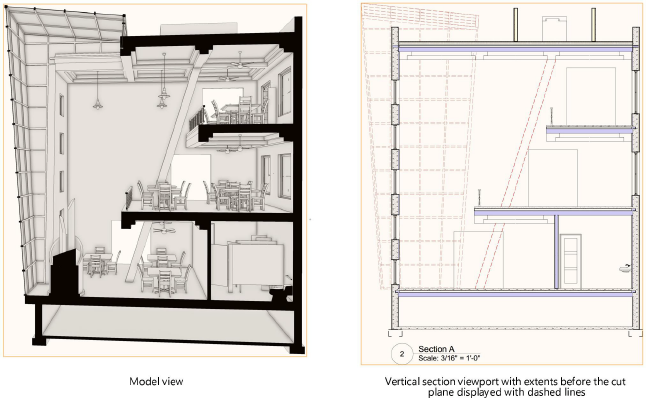

Vertical section viewports create a cross-section view of a model that can be customized in several different ways, as outlined in Creating section viewports.

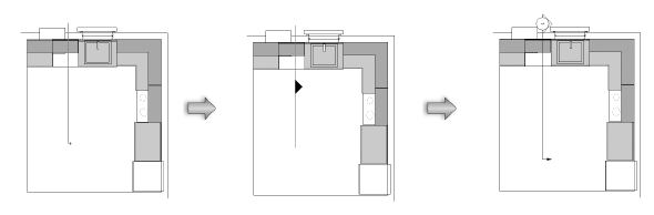

If you’re not using an existing section-elevation marker or clip cube to create the cut plane, draw the section line on the design layer or viewport.
Click in the drawing and drag the mouse to begin drawing the marker line. Click to mark the end of the line, and then click to indicate the side of the line to look toward (keep), which is indicated by a black arrow. Double-click to end the line.
To create a broken section line, click in the drawing and draw the first segment. Indicate which side of the drawing to show in the viewport. Click and drag to draw additional segments; broken section line segments are always parallel or perpendicular to each other (90° angles). Double-click to end the broken line.

Display extents before cut plane
Displays geometry before the section cut plane.
Available for design layer section viewports only when Display flattened is selected.
