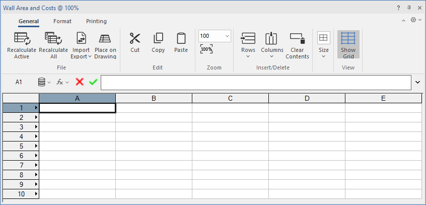

From the Resource Manager, click New Resource, select Worksheet, and then click Create. The Create Worksheet dialog box opens.
Enter "Wall Area and Costs" as the name for the new worksheet. You will add more rows and columns later.
A blank worksheet window opens. The tool bar at the top has three tabs: General, Format, and Printing. Below the tool bar is the formula bar, which you'll use to define the contents of the rows and columns of the worksheet. The rows and columns are beneath the formula bar.

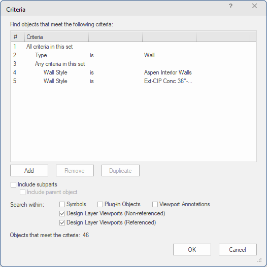

Right-click on the header box for row 3, and select Database from the context menu. The Criteria dialog box opens.
In row 1, the primary condition is already set to "All criteria in this set."
In row 2, click in each column to create the following criteria statement:
Type
is
Wall
If you wanted to include all wall styles in the schedule, you would stop here and not enter criteria for wall styles. For this tutorial, you need to include two specific wall styles and exclude all others, which will require more criteria.
Click Add, and then select "Any criteria in this set" in the Criteria column in row 3 to create a sub-condition set.
In row 4, create the following criteria statement:
Wall Style
is
Aspen Interior Walls
Click Add, and then create the following criteria statement in row 5:
Wall Style
is
Ext-CIP Conc 36"-Footing

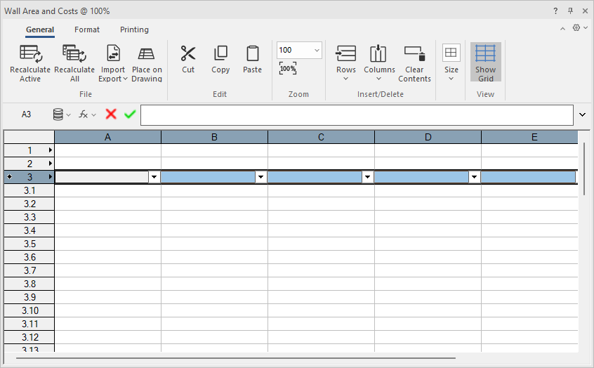

Click OK to set the criteria. The database of walls for the specified set of wall styles is created. The database header (row 3) now has a diamond next to the row number. Beneath row 3 are sub-rows for each object in the database.

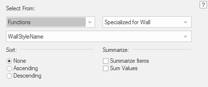

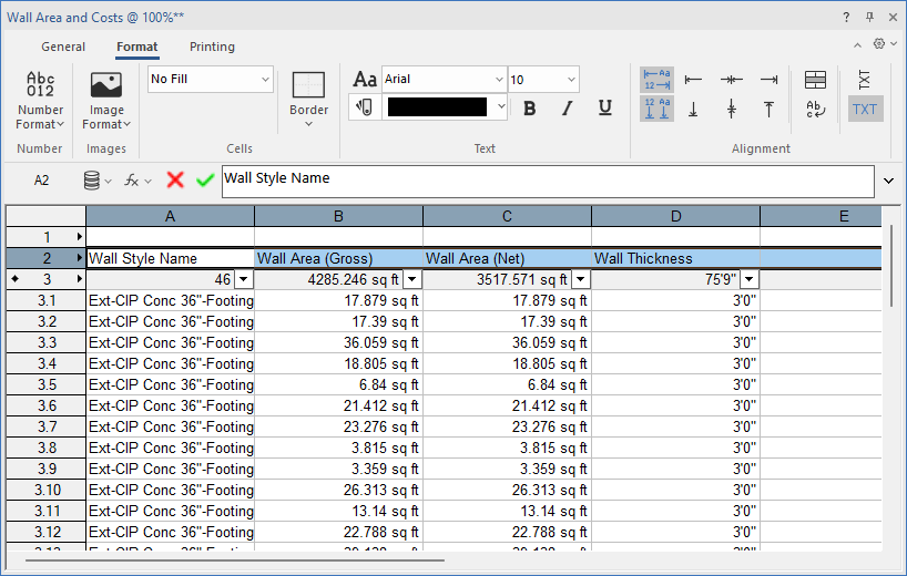

From each of the following cells, click the button on the right side of the cell to open a popover. Select Functions, then Specialized for Wall, and then select the function shown to extract data for each item in the database.
In A3 select WallStyleName
In B3 select WallArea_Gross
In C3 select WallArea_Net
In D3 select WallThickness
Alternatively, select Insert Function from the Function menu () on the formula bar to insert functions.

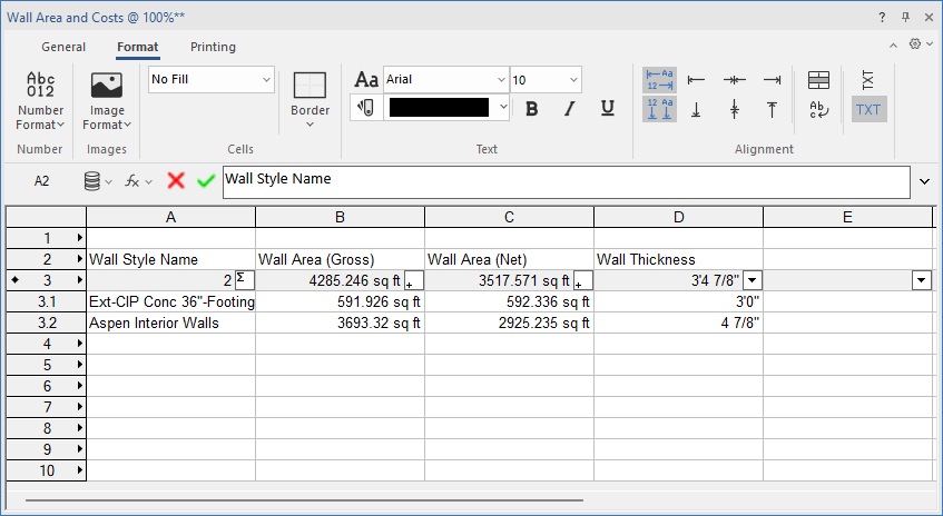

By default, numerical data is unformatted and must be formatted to display appropriate units. Formatting applied to a database header cell is automatically applied to all sub-rows for that column.
Click the Format tab on the tool bar. For each of the following cells, click Number Format and select the format option shown.
For B3 select Dimension Area
For C3 select Dimension Area
For D3 select Dimension
Add labels for columns A through D by typing names in the cells in row 2.
In A2 enter Wall Style Name
In B2 enter Wall Area (Gross)
In C2 enter Wall Area (Net)
In D2 enter Wall Thickness

The database header cell for wall styles is cell A3. Click the cell button, and click Summarize Items. The number of sub-rows is reduced to only two (one row per wall style).

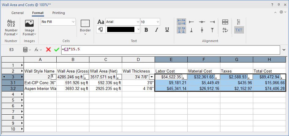

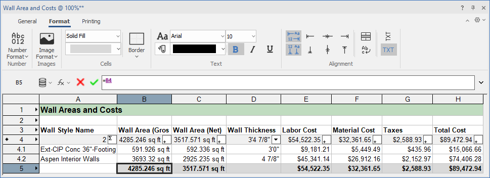

Click the following cells and enter the formula shown to determine the cost sums. Be sure to include the equal sign (=) before each item. When each formula is complete, click the green check mark or press Enter to validate the entry.
In E3 enter =C3*15.5 (multiply the value in C3 by 15.5, the estimated rate of labor cost per area unit)
In F3 enter =C3*9.2 (multiply the value in C3 by 9.2, the estimated material cost per area unit)
In G3 enter =F3*.08 (multiply the value in F3 by 0.08, the estimated tax rate)
In H3 enter =E3+F3+G3 (calculate the total cost of labor, material, and taxes)
Instead of entering the tax rate directly into the calculation, an alternative and more flexible approach is to set the tax rate in a separate spreadsheet cell and simply reference it in the calculation.
The numerical values in columns E through H are now dashes, because the cost is different for each wall. To show the cost values for all walls combined, click the button in E3, and click Sum Values. Repeat for cells F3, G3, and H3.
Format all of the cost data to show as dollar amounts. Select the four cost header cells (E3 through H3). From the tool bar's Format tab, click Number Format and select the options shown.
Select Decimal
In Dec. Places, enter 2
Select Use Commas
In Leader, enter $ (dollar sign)
Step 7: Set up column totals, and add and delete rows

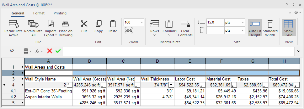

Next, set up totals at the bottom of the columns as appropriate. The cells in the database header row (in this case, row 3) display sums for all of the database columns. Reference these database header row cells in spreadsheet cells to set up the totals.
To set up the totals:
Click the following cells and enter the formula shown to show sums from the database header row. Be sure to include the equal sign (=) before each item.
In B4 enter =B3
In C4 enter =C3
In E4 enter =E3
In F4 enter =F3
In G4 enter =G3
In H4 enter =H3
Select cells B4 and C4. From the tool bar, click Number Format and select Dimension Area.
Select cells E4 through H4. Click Number Format and select the options shown.
Select Decimal
Select Use Commas
Click cell A1 and enter Wall Areas and Costs as the schedule title.
Select row 2, right-click, and select Insert Rows Above to add an empty row between the schedule title and the column labels.
Select the empty rows at the bottom of the worksheet (6 through 11), right-click, and select Delete Rows.

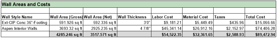

Finally, select cells and use the tool bar's Format tab to format the worksheet. You can change the font, font style, size, and color to format the text. Add cell borders, and change cell background color, as desired. Change the text alignment in cells, and resize rows and columns, if necessary. From the General tab, select Place on Drawing to place the worksheet in the drawing area.
See Worksheet: Format tab for details.
Formatted worksheet placed in drawing
