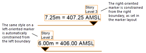

Constrain object distance from boundary |
Constrains the distance of the selected object from the specified boundary (left, right, or both), for a marker oriented to the right side of a drawing object. If you draw the marker oriented to the left side of a drawing object (reversed) the constraint is also automatically reversed.
