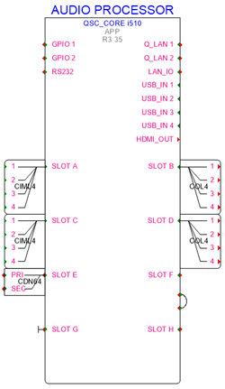

A socket is a port on a device through which a signal flows. Devices can incorporate any number of input (IN), output (OUT), or input/output (IO) sockets. Since signals typically flow from left to right, place input sockets on the left side of a device and output sockets on the right. Sockets are automatically named based on the selected signal type and socket type (IN, OUT, or IO); you can also specify names or a custom naming convention. While sockets can be placed on the top side of a device, that area is normally reserved for the device name label.

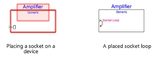

As sockets are placed on an existing device, they automatically become part of the device.
A socket loop places three objects: a socket, an adjacent socket, and a loop on the same device (creating a “loop-thru”). If adjacent input or bi-directional sockets are already present, the Socket Loop tool connects them with a loop. Multiple loop-thrus can be connected in a chain, to send the same signal to several locations.
The Terminator tool adds or removes a terminator. Terminal sockets cannot be connected.

Click to place the socket or socket loop into the drawing, normally on a device.
If placing the socket on an existing device, the device is highlighted and the socket or socket loop automatically becomes part of the device.
